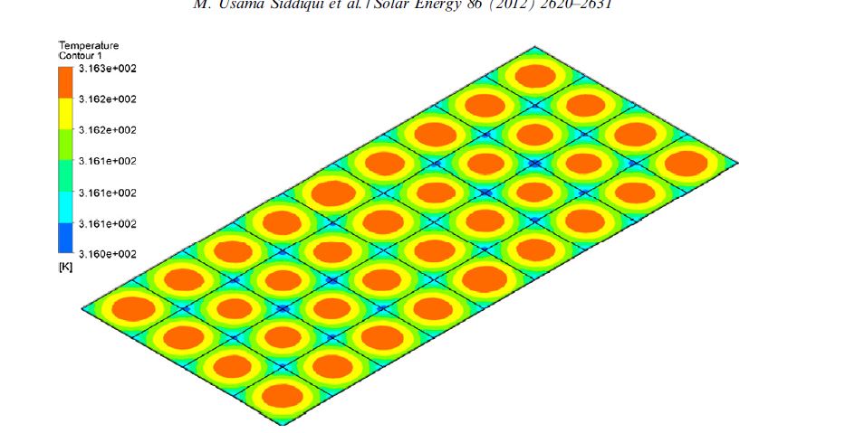

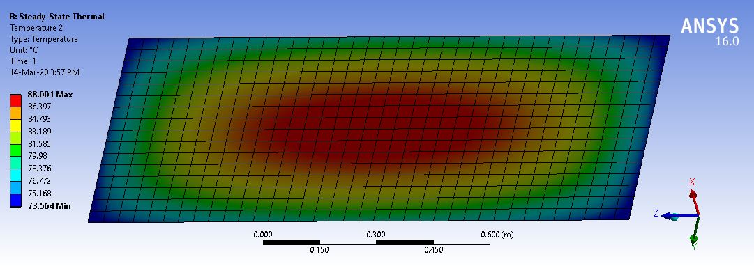

Can you reproduce the plot shown in the paper if you apply the same material properties and conditions as those used in the paper?
Note that the plot from the paper is showing a temperature range of 0.003 C while your plot has a range of 15 C so that is a huge difference.
