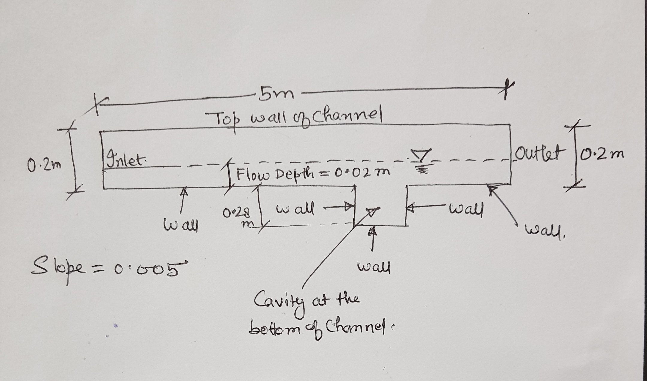

I want to perform steady-state flow simulation in 2D open channel using VOF model. Can I use the SYMMETRY boundary condition at the top wall of the open channel? The image of the model is attached. I am a beginner so somebody please kindly help me out. I have used pressure inlet and pressure outlet at the top wall of the open channel but nothing worked.
