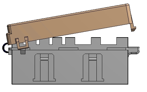

Attached is an ANSYS 19.2 archive that rotates the hinge 170 degrees.
You can animate this result.
I assume the next step you want to do is to have the snaps close. To do that you will have to change the rigid body to a flexible body and add frictional contact between the snap faces. This will greatly increase the number of nodes and greatly increase the solve time. Good luck!
