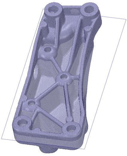

What units are the data in the STL file?  Inches, mm?
The way to use this file is as a template to create real solids from scratch while using the STL facets to help size the features.

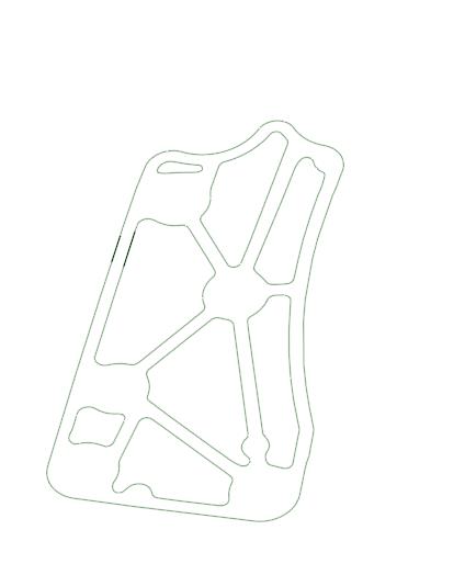

Here is the facet body...Create a Plane then use the Tools > Extract Curves tool to get this...
 You can sketch over those rough shapes to make surfaces that can be pulled into solids and then worked on from another angle.
