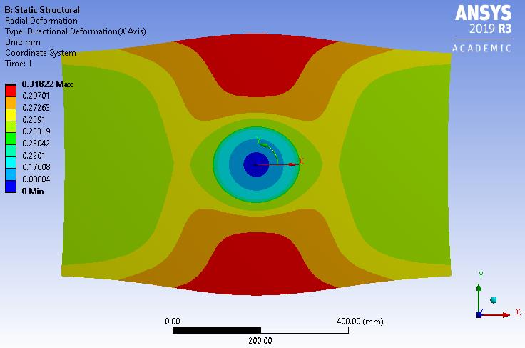

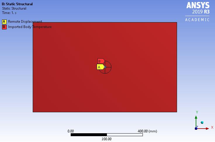

This Static Structural model is held by a Remote Displacement at a single vertex at the center.
Try to use smaller elements and try to increment the nonlinear solution more gradually and you can obtain a solution where the plate remains flat.

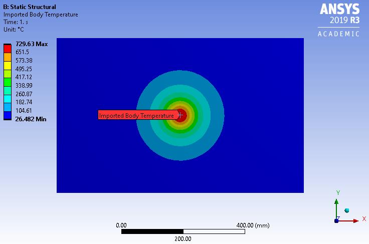

If you want the temperature load to "potato chip" the sheet, then you need to provide a geometric imperfection or an initial load to bend the part out of plane.
