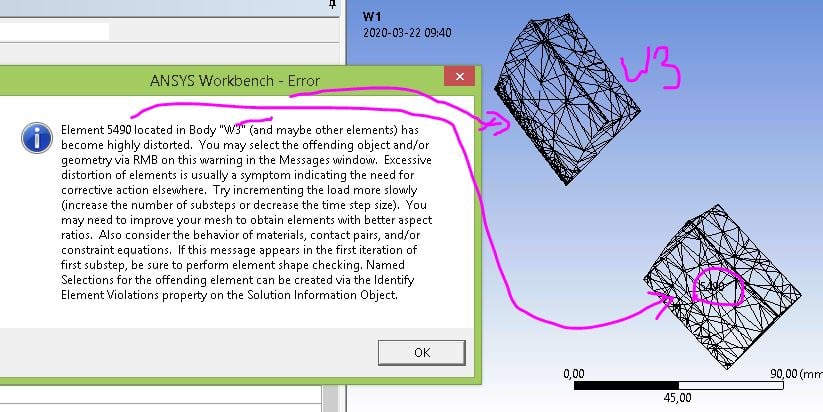

"..elements connected to nodes."
Is this are you talking about?  I've nevere used this.
And in a mean time I found that 5490 from element W3 was moved to W1 area... I've never seen that... looks like it flew into space.
It's due to large strain of steel comming from huge temperature gradient
