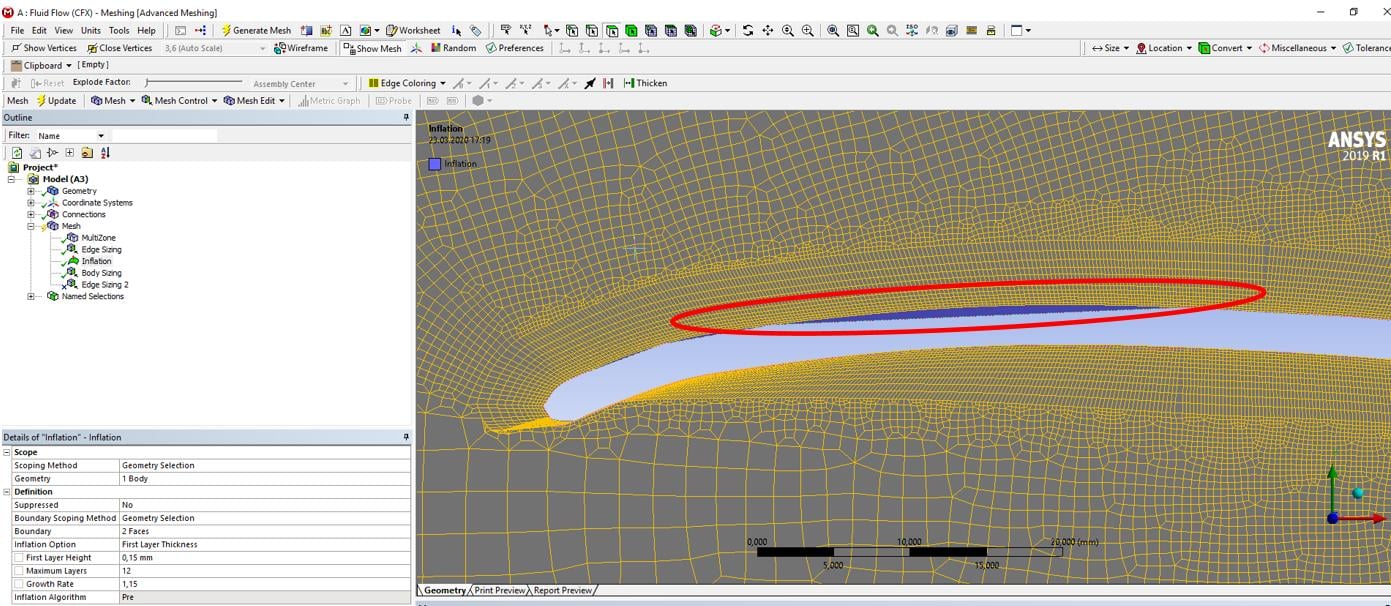

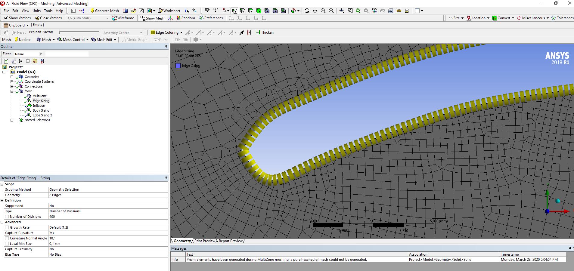

The curvature size function helps until the inflation is unsuppressed

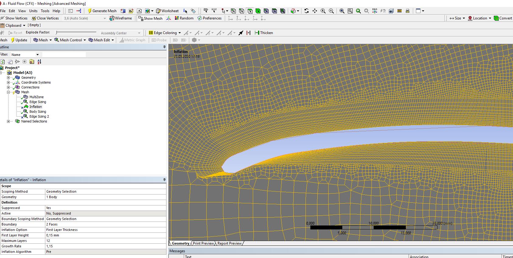

Could it be that the imported Step-Model consists of too less X/Y Points? If the Inflation is suppressed it looks like this

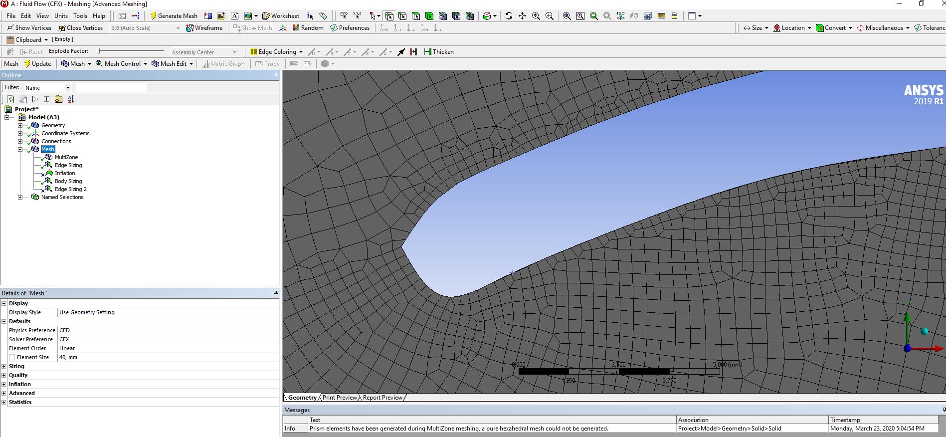

And after unsuppressing there is a part of the inflation inside the airfoil
I don´t know if it´s possible to change the inflation?
