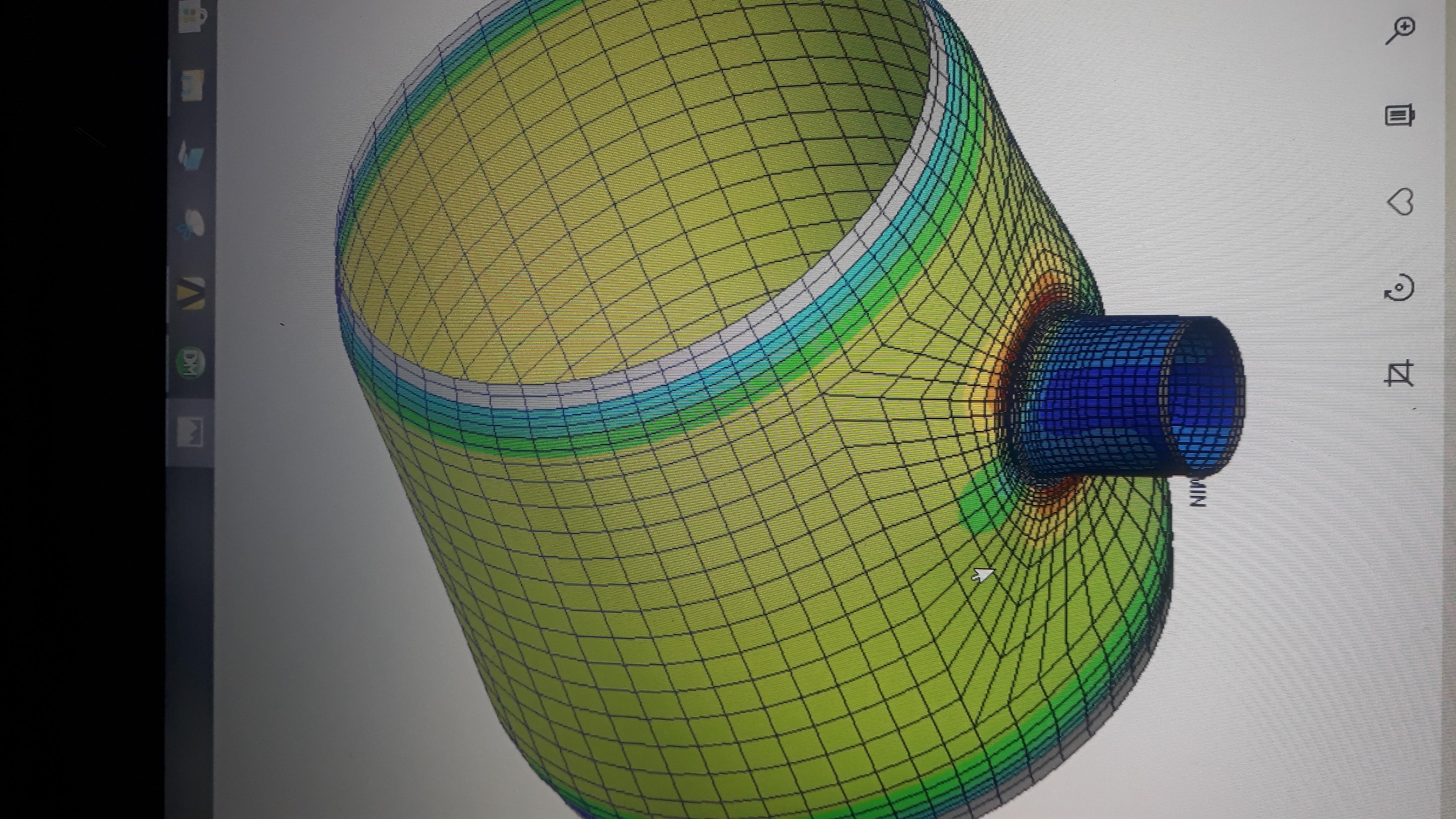

Do you mean you want the square pad around the circular hole?  Why is that important?  What does your mesh currently look like?
To make a square pad on a cylindrical surface, in SpaceClaim, create a plane using the circular end of the small pipe. On that plane, draw a rectangle. Use the Project tool to project those curves onto the cylindrical face.
Please use the Windows Snipping Tool to clip a screen snapshot and use the Insert Image button to put it into your reply.
