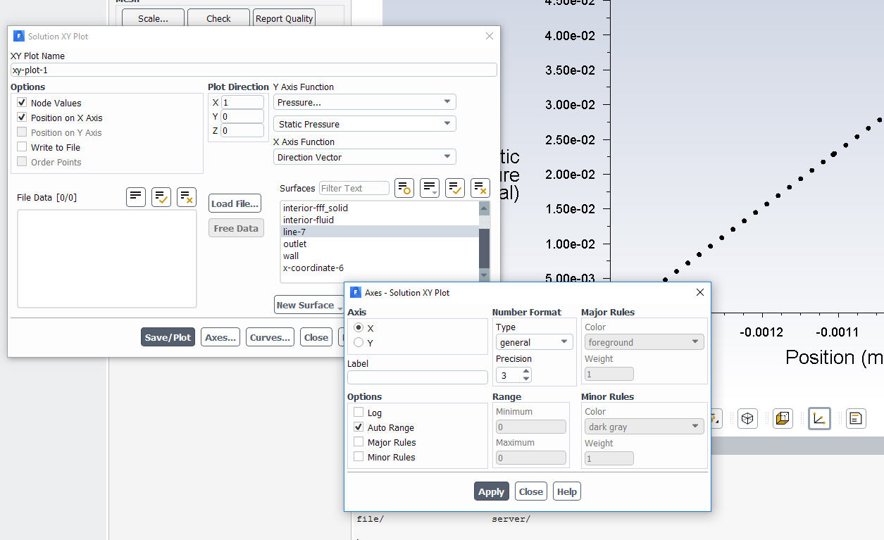

you should be able to select a line.
how are you creating a line? use results - create - line.
for range, you can use axes option.
in cfdpost you can add static and dynamic pressure and create a new variable to plot.
