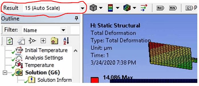

You click on the pull down and select 1 (True Scale) or type a 1 into the text box to replace the 15 in this image or the 20 you had.
