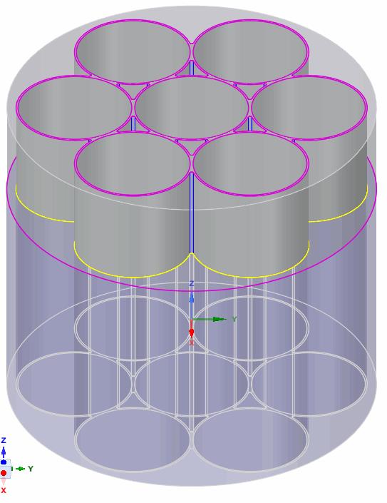

With the single face inlet, you can sweep the mesh in the straws and the triangles between the straws, but you will have a tet mesh on the inlet plenum.
The previous post described how you could have 14 faces on the inlet in the same pattern as the straws and triangles, then the entire volume can be swept.
