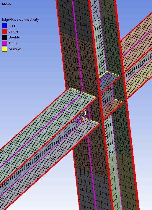

The Mesh Merge has stitched all the meshes together. You can see this using Edge Coloring and set it to By Connection.
