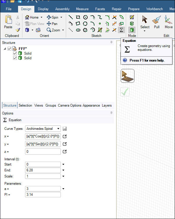

If you have profiles, you can use skin/loft in DM.
Or blend in SpaceClaim.
In SpaceClaim you can create curves with equations
