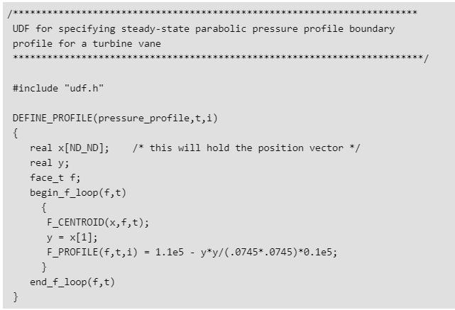

Our apologies for this delayed response. I'll try and help you with this issue. Are you able to compile any UDFs at all on your system?
Could you please try to compile a simple UDF like this one here? Please let me know if you are successful. Please use a serial launch.
Thanks.
