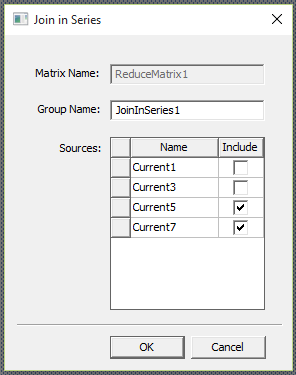

In Maxwell 2020R1, we changed the way that matrices are reported so this is the source of the confusion. It is now done in the same way as in Q3D. This was done mainly to eliminate confusion with stranded windings regarding assignment of Turns and Branches.  The Maxwell grouping function now uses the Q3D reduce matrix operations with the new Join in Series and Join in Parallel operations. nTo create a reduced matrix, the user will right-click on an existing Matrix parameter. The user can then select Join in Series … or Join in Parallel. The source selection dialog will appear. Once a Reduce Matrix is created, it will appear in the project tree under its parent Matrix parameter. The user will be able to edit, rename, and delete Reduce Matrices using the usual methods (menu, keyboard, …)nn
