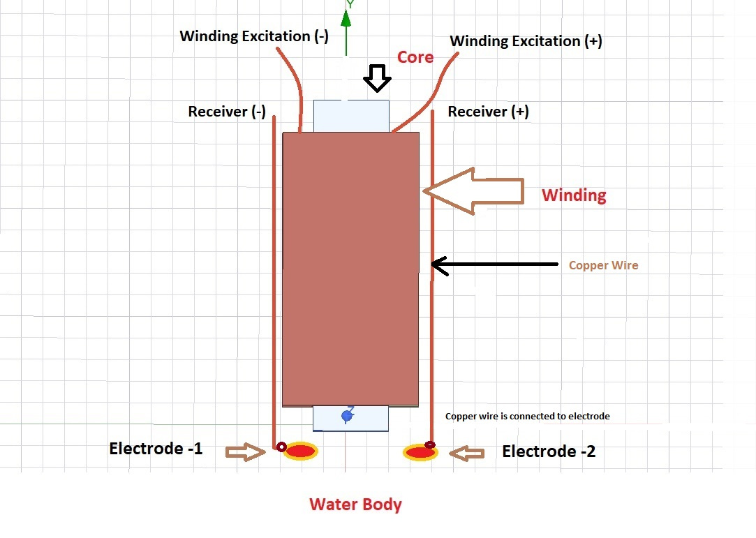

I'm looking for simulating a water flow meter in Maxwell3D. It based on the principle of Faraday's Law of Electromagnetic Induction, according to which liquid generates voltage when it flows through a magnetic field. The voltage produced is directly proportional to the water movement. The voltage signal is processed into the volumetric flow rate by the electronics. ni would like to know how to apply water flow movement in simulation thus by calculating the pickup voltage through receiver wire.n
