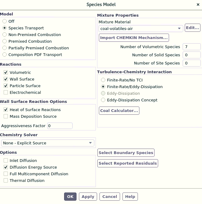

Can you share a screenshot of the species model that you are using(along with coal calculator)? It is a key parameter for combustion and shouldn't be missing. I have been using the species transport model and have been adjusting the parameter by selecting coal-particle from Materials->combustion. Sharing screenshots for a setup that I had used earlier.nnnnn
