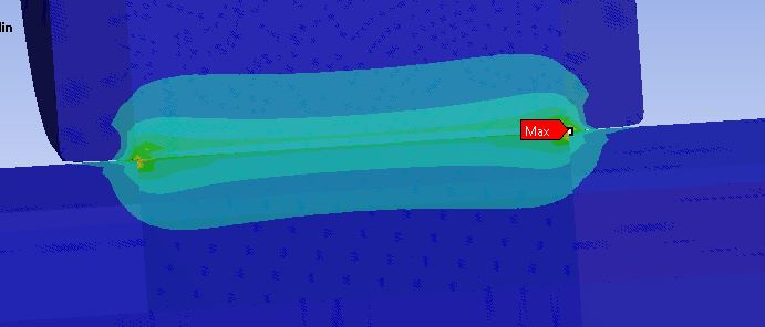

Hi PETER,nThe logirthmic profile is the shape of the rolling element.n
The stresses need to be having this shape and the maximum stress is obtaining at a point shown below in the picture below. This picture is taken after changing the suggestions made bz zou in the previous comment. i.e changing the displacement convergance tolerance and the updating the stifness factor to 10 and updating for each iteration. n
I have split the rolling element and the shaft into bodies in the spaceclaim for better meshing.. does the meshing is the reason for this results.?nThanking you.n
