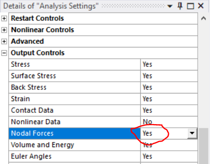

nnThe question mark against the Force Reaction result object indicates that you have not turned on the Nodal Forces output. Can you turn on the same?.nIf this is turned on then the question mark must disappear and on resolving you must be able to view the results.nnRegards,nAshish Khemka
