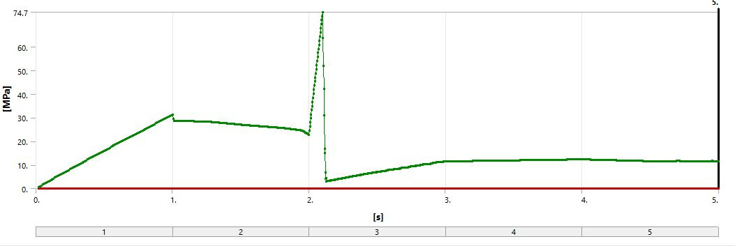

Can you please suggest what and all condition can lead to sudden drop in contact pressure as seen in attached image in 3rd step. In 3rd step differential pressure is applied on the C component between the plate. I have been changing the numerical damping value in Analysis setting to check Impact load issue while differential pressure is applied. Also tried by varying stabilization damping factor in contact controls it didn't help much.n
