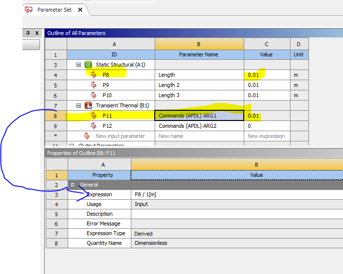

nIn details of command object, you can toggle on the boxes next to Arg1, Arg2 etc to create input parameters:nnYour command object can then use ARG1, ARG2 etc as variables:nExample:n nsel,s,loc,x,(ARG1/2)nIn WB project page, double click on parameter set. Then set ARG1 equal to length parameter you have defined/imported from CADnExample:nIn the example above, I am setting P11 (this is ARG1) equal to P8(length parameter) divided by 1 unit to make P11 dimensionlessnn
