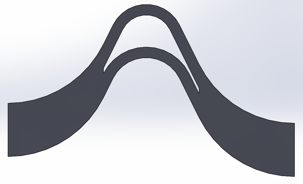

Hi, I have the same problem.nFor my master's thesis I'm simulating the flow around blades of a steam turbine. I want to generate an unstructured mesh with an inflation layer at the walls (for k-omega SST model). Addytionally at the top and at the bottom boundary I need periodic boundary conditions. Hence I need the match control. Out of any reason match control and an inflation layer is not possible at the same time. For the geometry I'm working with Design Modeler.nAttached you can find a picture of the simulation domain. Left boundary = Inlet, Right Boundary = OutletnnDoes anyone know how it is possible to fix this problem? (Design Modeler, Ansys Meshing, Ansys Fluent)nnThanks a lot!n
