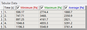

nWhy do you need the stress of each node? That seems like 99% unimportant information and 1% important information.nUnder Analysis Settings change the Number of Steps to 5.nThen on the Details of the Pressure load, there is Tabular Input, just type the 5 values you want to sweep over.n
The solver will be able to show you the stress results at each step, but you could just take the Tabular Data of the Stress plot, which will have a column for the Maximum Stress at each step.n
You can copy and paste the data from those columns into Excel to plot Maximum Stress vs Pressure.n
