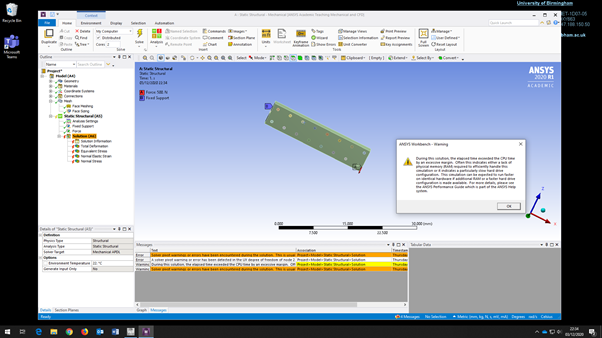

I have another question, because my original sample is too big and meshing would take days, I have cut it into small samples. However when I am trying to do 3 point bending on it I still get these warnings: n
Mesh size 0.124mm, and my structure is a carbon fibre reinforced composite. Carbon fibres have a coating, and matrix is graphite. I am just wondering why I keep getting these errors? n
