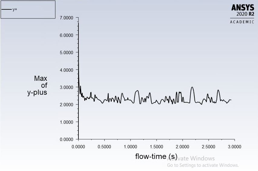

nThis is the simulation results with k-w SST PISO (First boundary layer = D/1000 Mesh where D = 0.1m) with a time step size of 5x10^-5. This is what I meant by disorder.nn
