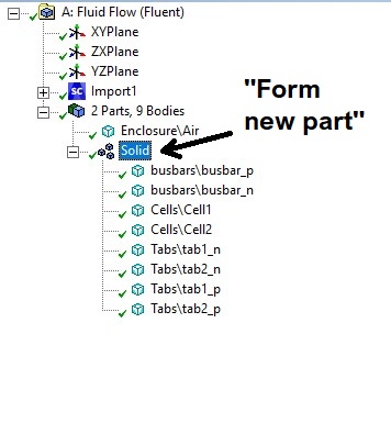

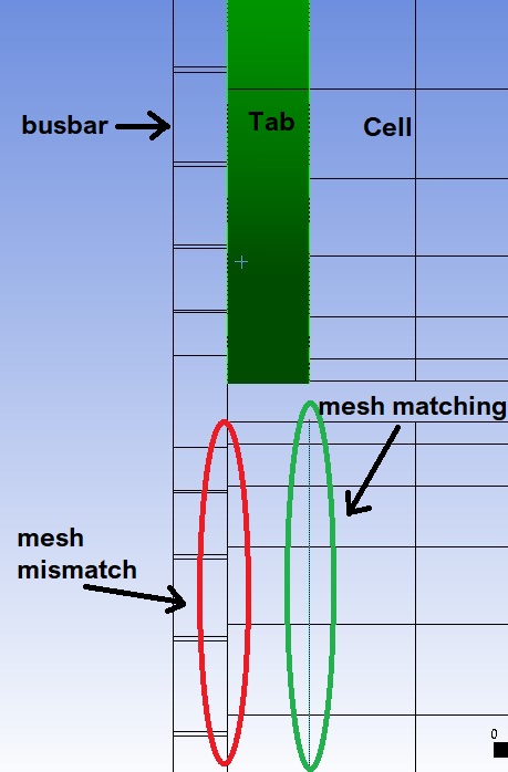

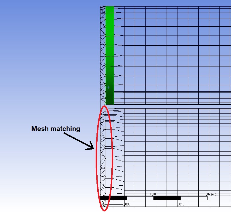

Thank you! I found out a mesh discontinuity between busbars and tabs, that didn't occur in the air+ single tabs or no air + tabs + busbars models.nI fixed it creating a new part for the solid part in Design Modeler:nCould you tell me how can i do the same comand (form new part) using space claim ambient?nThank you for your help!n
