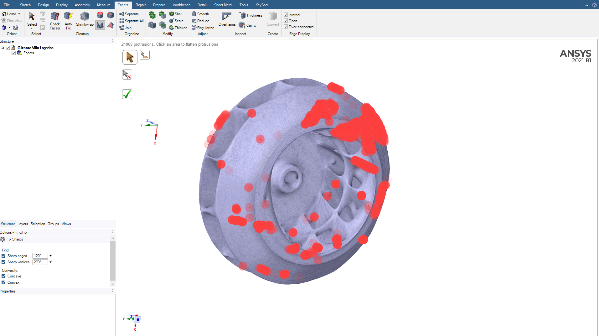

Dear Keyur,nnThanks for your response. I will have look into the help manuals for sure.nIn the meanwhile, I think I have found the main problem: there are too many sharp angles.nI have tried to press the green V of the picture below but I couldn't solve the problem.nIs there a best practice to remove sharp edges? You can find one example below.nnThanks,nMauronn
