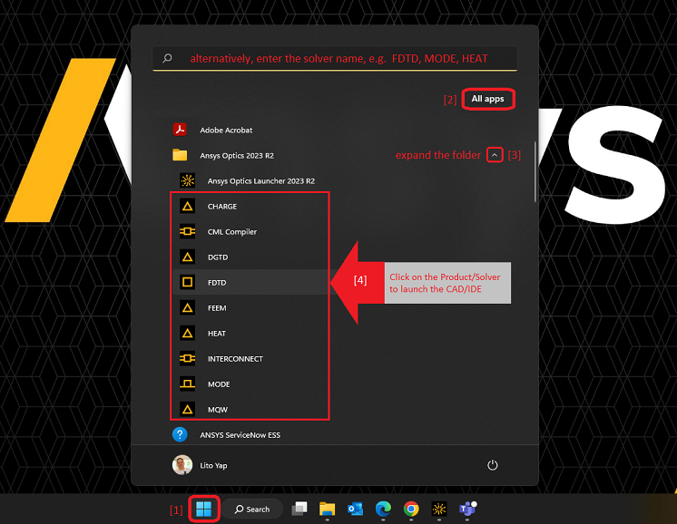

Run/Open the Lumerical CAD/GUI directly from the Start Menu (see image below) and send a screenshot of the error message.
