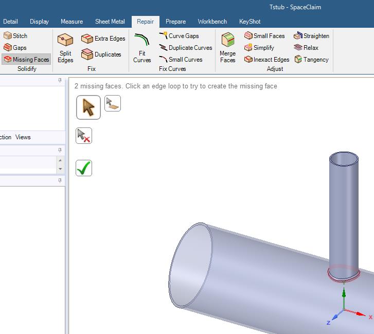

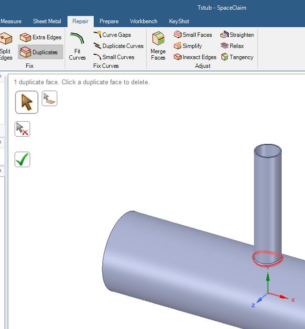

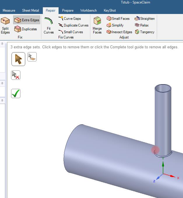

Aniket's suggestion #3 was used with the SpaceClaim repair tools to repair some problems and to set Share Topology to Share.
But even after that, I did not get a good mesh.  So I went back and Combined two solids, and deleted one face.
Then I finally had a good geometry for meshing.
