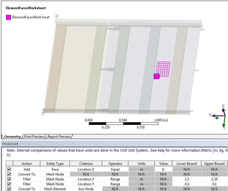

I created a named selection using the Worksheet option to select Element Faces within a range of X and Y coordinates as shown below.
However, when I tried to use that Named Selection in a Pressure, it wouldn't take it. I wonder if someone knows why.
I also tried to make a Named Selection of Nodes, and couldn't get that to show up in a Force assignment either.
