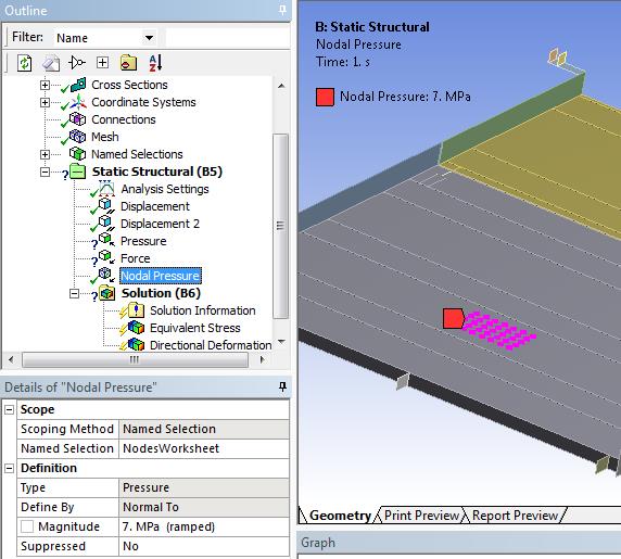

I see it now!  I almost never apply loads direct to nodes but thanhttdt has a good application for it.

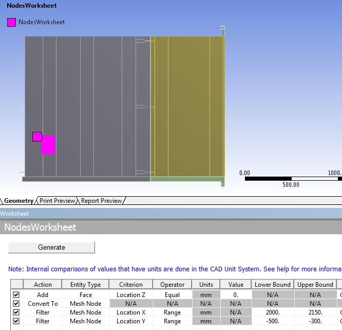

You can now easily edit the Upper and Lower Bound values to move the pressure around.
The next improvement would be if you can have those Upper and Lower Bound values be parameters!
