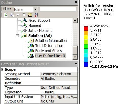

Below are snaps from Jason's example of using LINK180.
I see it starts as a line body in DesignModeler (or a Beam in SpaceClaim).
Then the force in the link is easily extracted in the results.
Thanks Jason!
