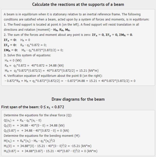

From the paper, M = PL is equation (4), which is for a point load P at a distance L from the column.

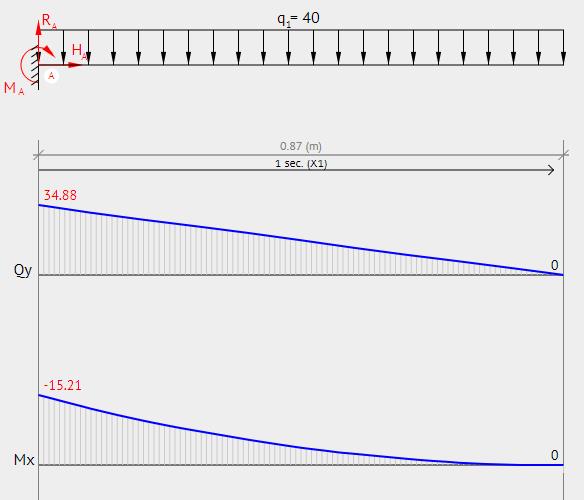

You have used a distributed load, q = 40 kN/m for a length, L =  0.872 for the symmetric half model.
You calculate the beam shear and moment diagrams for your problem.  I used an online calculator.
So when q = 40 kN/m,  M = 15.21 kNm
