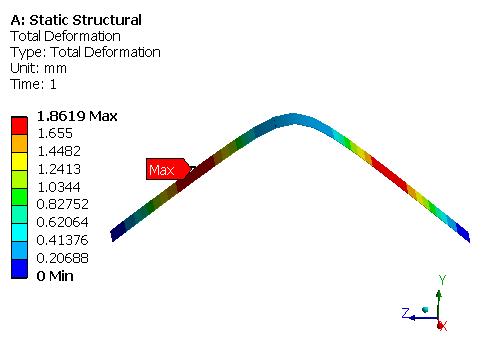

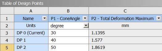

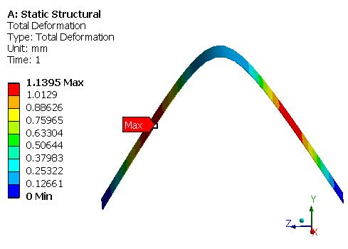

Attached is an ANSYS 18.2 archive that implements a cone sliced by a plane and the hyperbolic edge extruded as a thin arch. The cone angle is a parameter. Workbench can march through a Parametric Table of Design Points automatically.
Are you working on the free Student license which has no SOLIDWORKS bi-directional interface, or a Research license that includes the SOLIDWORKS bi-directional interface that allows SOLIDWORKS parameters to come into ANSYS?
