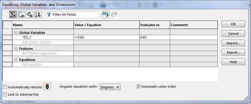

Here is what I found searching the Internet.  I tried that on your SW part.
I create a Global Variable "DS_c"
Then I use that variable in the Curve Equation.
Unfortunately, when I created a parameter for 29.32, this did not seem to update the geometry.
There was another page that had a different approach to creating Parameters that also claimed to update, but that was more work and I haven't tried it yet. Have you tried any of these methods?
