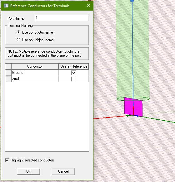

Yes driven terminal should work (HFSS > Solution Type... > Terminal).
Create a monopole on a ground plane as shown below.

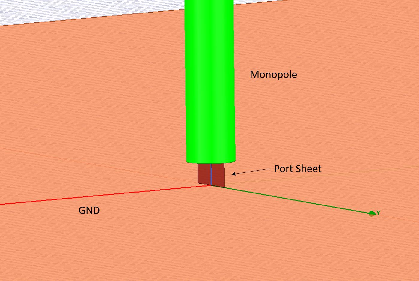

Create Lumped port on port sheet as shown below.

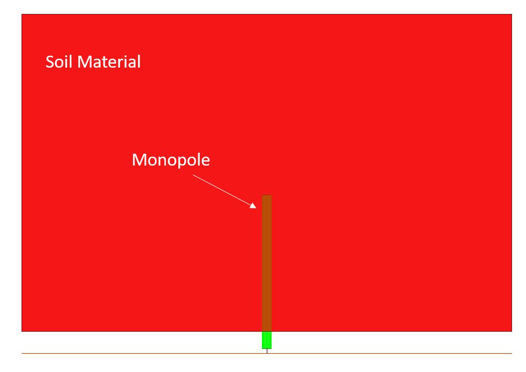

Now just cover the submerged part of rod with soil material as shown in figure below.
Plot smith chart to get input impedance.
