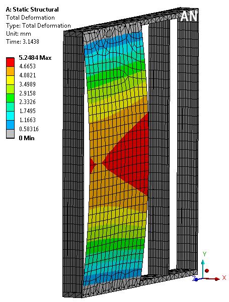

Hi Connor,
Under Mesh Details, I set the element order to Linear to get rid of the Mixed Mode warning. I don't know if that was required or not.
I also saw that the nails only fasten the first sheet to the rails, so I suppressed the second sheet.
I fixed up the BCs and it ran.  Were you going to run some nails down the studs?
