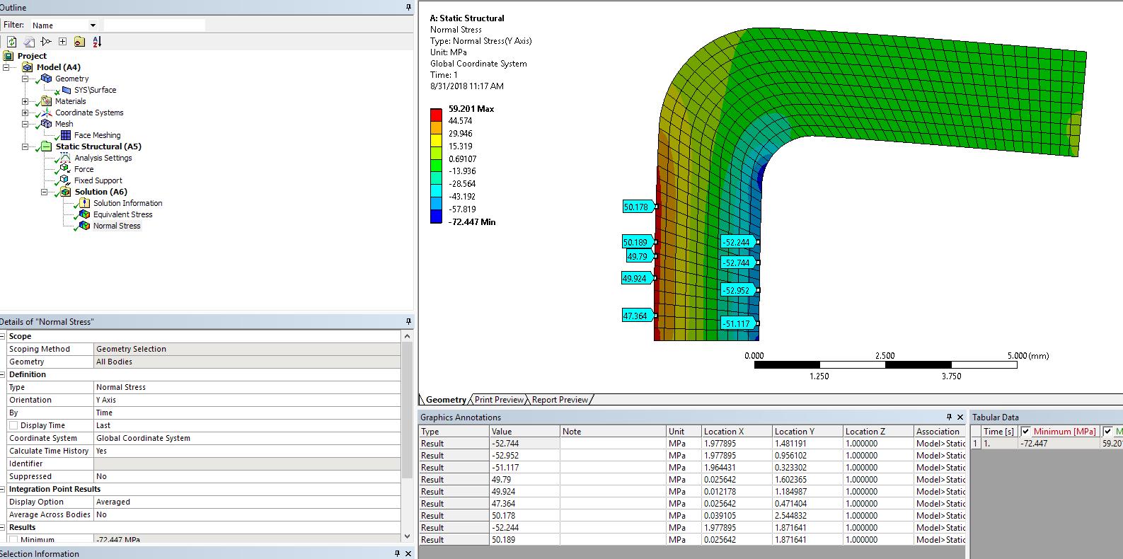

Hi Adisa,
In addition to the geometry changes that Peter pointed out, consider performing this as a 2D analysis. Here are the results that I got making the geometry changes + performing this as a 2D analysis. I think this way the out of plane Poisson's effect that might be present in a 3D model will be ignored.
