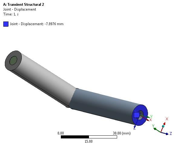

Hello Masud,
You have conflicting boundary conditions.  On one end you have zero displacement,
while on the other end you have a Translational joint displacement of 8 mm.
I assume you meant to leave the Y axis free in the Remote Displacement.
You might have better luck with convergence if you just apply displacements to bone faces and leave the muscle to just bond to the bone.
