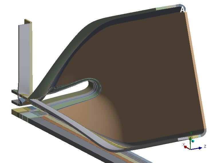

Using displacement reveals another contact needs to be added to the model: one between the top and bottom inside faces of the large tube, which passed through each other during this simulation.

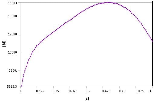

Here is the reaction force to go down 150 mm.
