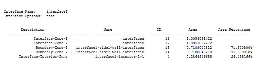

Can you go after initialization to the Mesh interfaces and list the interface to check the portion of overlapping and non-overlapping regions on your interface. The same can be done via Graphics under Mesh variables (Interface Overlap Fraction).
sorry i cant understand how to do that , im using fluent 18.1
