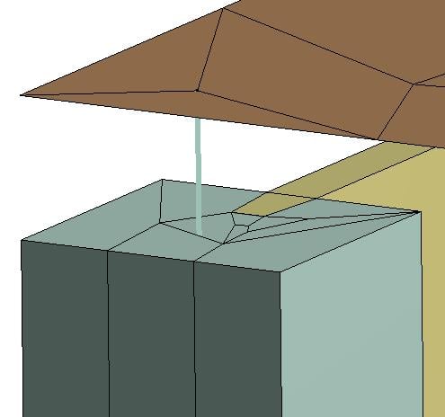

Hi Connor,
The problem is the Beam is not connected to the Stud.

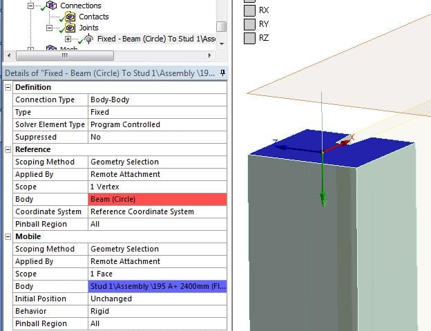

You can add a fixed joint between the end of the beam and the face of the stud.
Do this for the 10 beams at the top of the studs and the 10 beams at the bottom of the studs. There is some automation called the Object Generator that could do this, but you have to do some setup to make it run.
