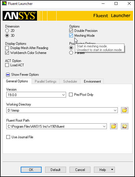

You can do meshing in Fluent when you start Fluent in Meshing Mode. Here you can import stl or any cad file. But it would be a faceted data. Then you can do surface meshing of wrapper. For more information, please see help.
