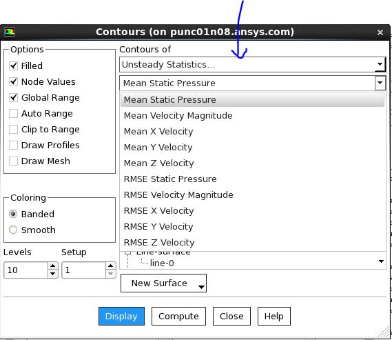

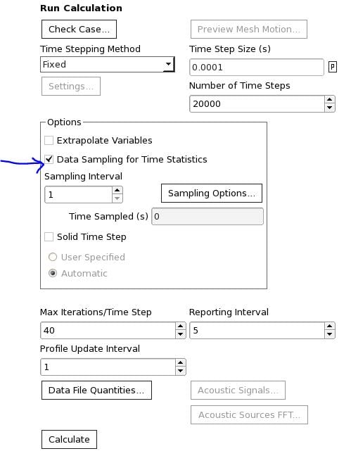

Hello Montovani,
I guess you would like to post-process the unsteady statistics in your transient simulation. To get the unsteady statistics in the transient simulation, one needs to turn on "data sampling for Time Statistics" and run the case at least 3 - 5 flow through times. Then you can post -process the mean and RMS values of flow variables. I hope this help you to clear your question.
