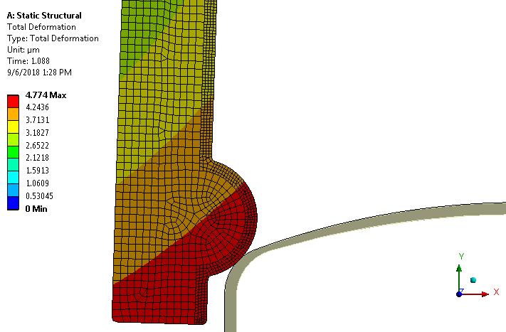

All the changes are incorporated in this archive that seems to make good progress. The X=0 Displacement is only on two faces of the flexible body. It doesn't apply to the Rigid body.

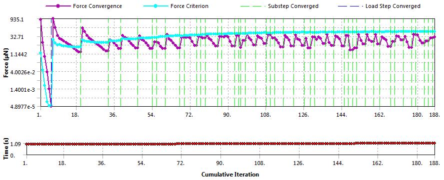

The only change I would make is to the Minimum Substeps in Step 2. 500 is larger than necessary. Back off to 100.
