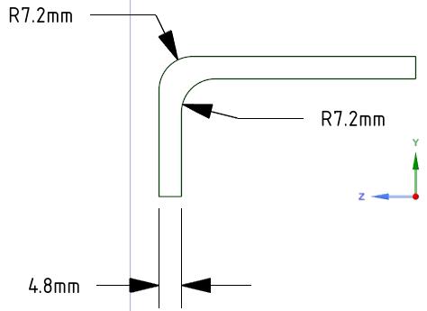

This is your corner dimensions:
Keep the 7.2 mm inner radius, but to maintain a constant wall thickness, the outer radius must be 7.2+4.8 = 12 mm.
This change may also improve the shape of your elements!  The 4-element thick model is still running, but maybe it needs a new corner radius?
