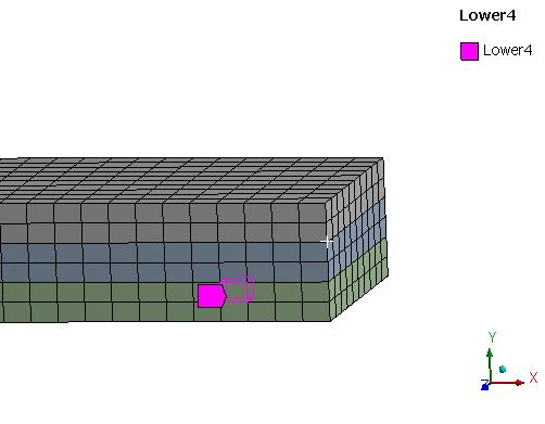

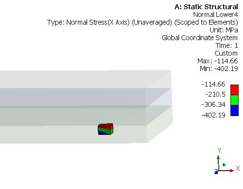

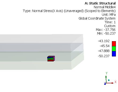

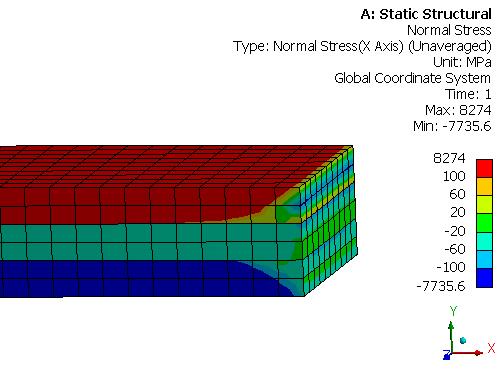

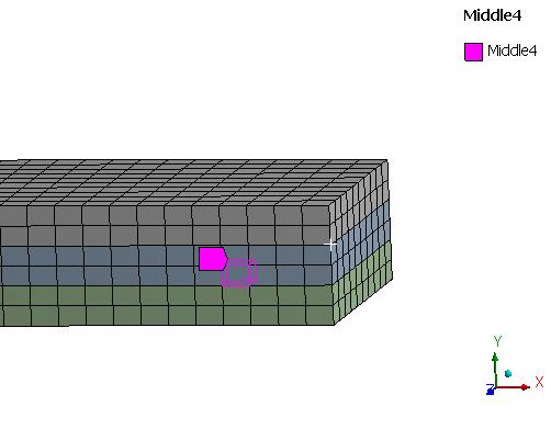

The following plots are made with 0 deformation so I don't lose track of which element is being plotted.
Below is the Normal Stress in the 3 layer sandwich where I have a very coarse mesh.
I created two named selections, but I picked the fourth element back from the end to get a larger difference.
