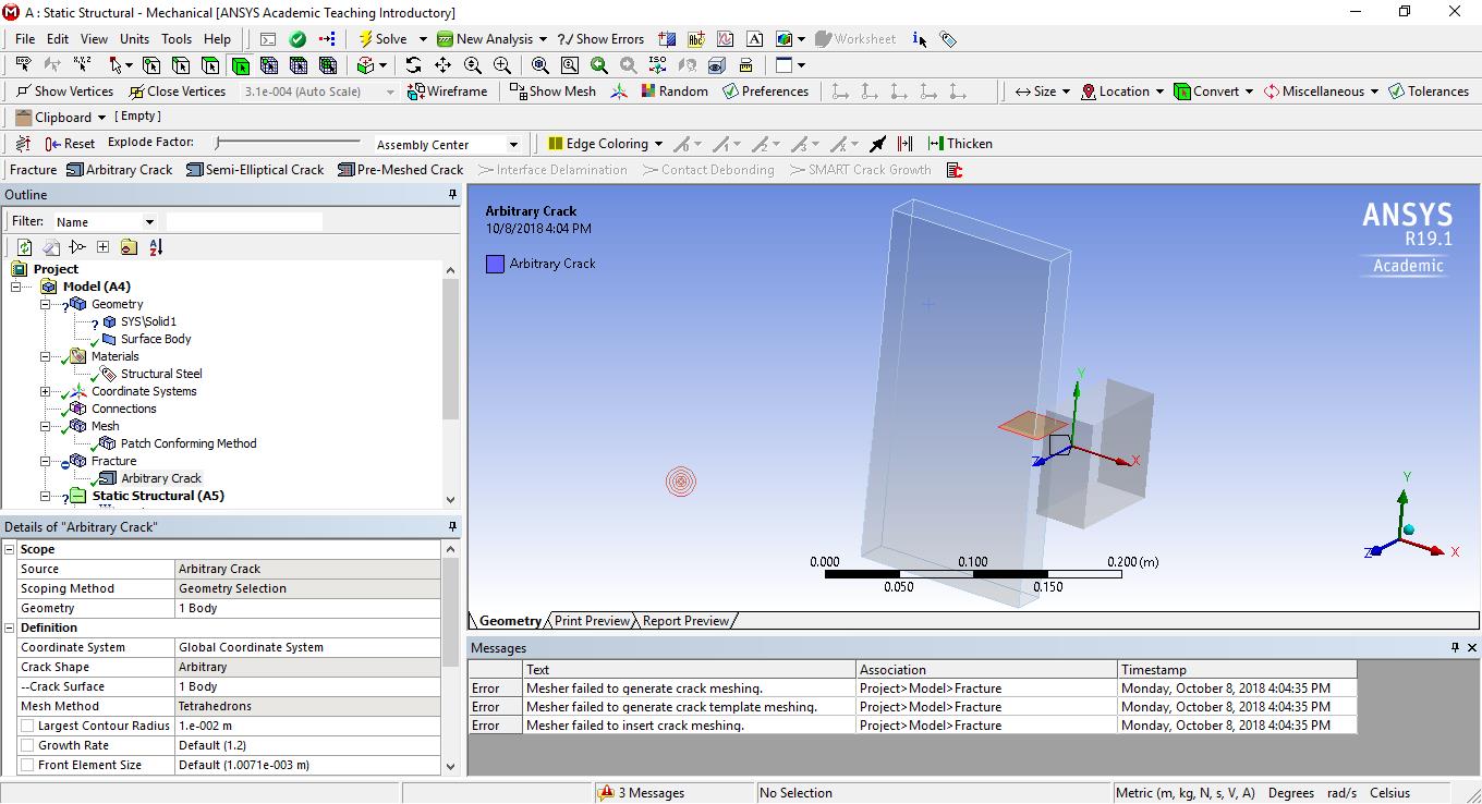

I have made some progress.  I created a 3D extrusion and then used the thin/surface option by removing some faces.  It appears that I have a solid body in the correct position.  I did try to insert the crack, but I now get an error (see attached image).  Any idea as to why I am getting this error message?
