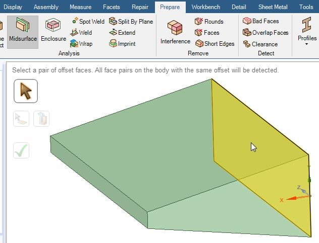

Hi Kiran,
If you are in SpaceClaim, you cannot generate a Midsurface unless the faces have a constant wall thickness. I constructed the wedge below. Note that the Midsurface tool will not select the non-parallel faces.
Another CAD system can create that Midsurface and its FEA model has variable thickness shell elements.
I recommend you keep the part as a solid and mesh with solid elements.
