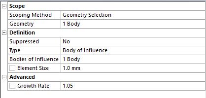

Hello Yanki,
You should be able to find 'BOI' option when you 'Insert' the 'Sizing' feature in WorkBench Meshing. You will have to select the 'Body' filter. You should be able to see the body of  influence feature in type. Here is a screenshot.
Here are some links you might find useful.
I hope this helps.
